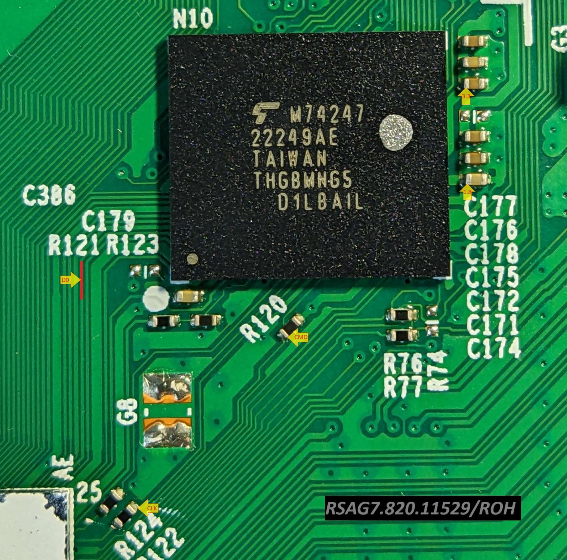

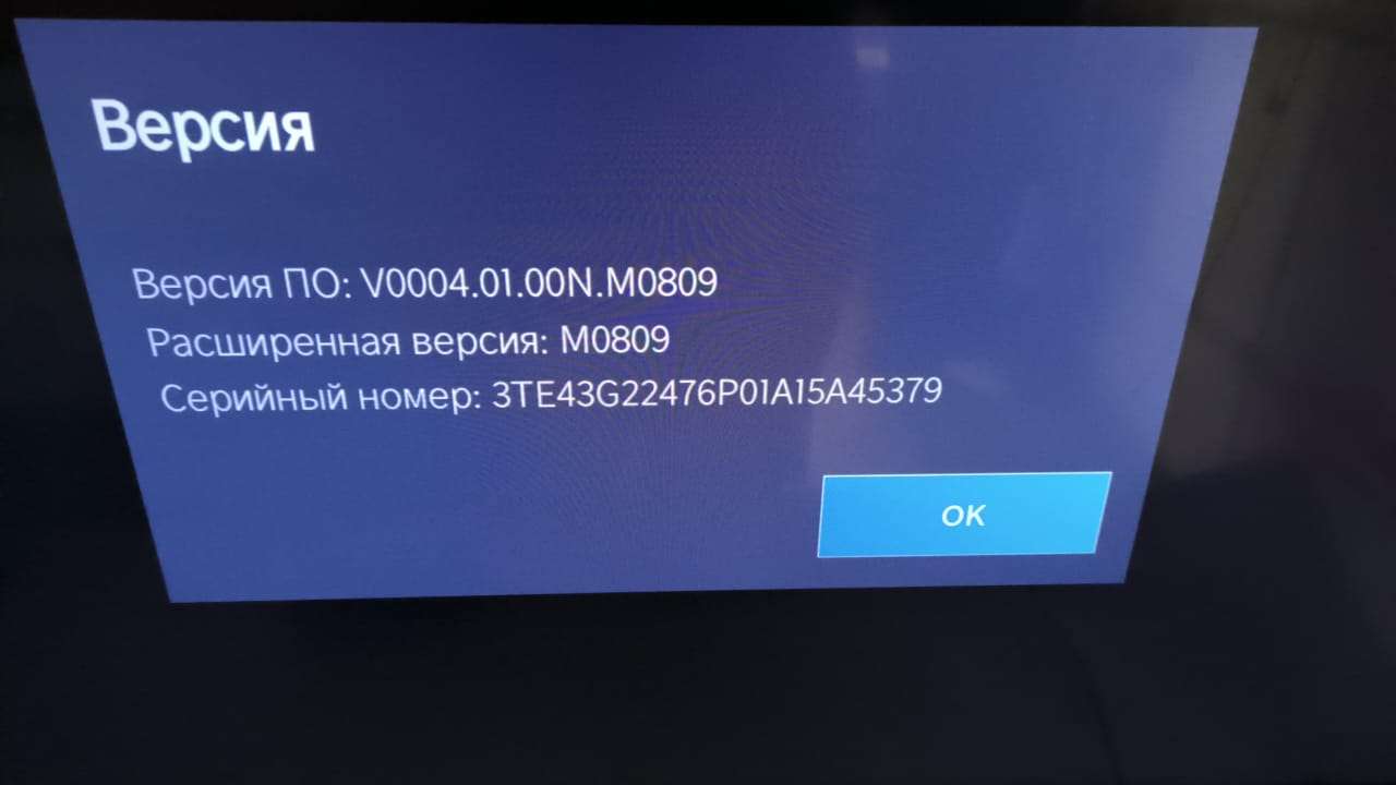

HISENSE 43A6BG Шасси (Main Board): RSAG7.820.11529/ROH
Аппарат прибыл на ремонт подсветки! Прошивка считана через колодку.
050: SyncFIFO Mode. Speed set to level 0. 051: VCCIO: 3.3V 052: Chip pins contact is detected OK. 053: Identified the genuine adapter:RT-BGA169-01,V2.5, SN: 20240509083554-S37287 054: eMMC OCR: C0FF8080 055: eMMC CID: 110100303034474130029EC9E21E69 056: eMMC CSD: D05E00320F5903FFFFFFFFE7924000 057: Chip ID:00010011,Chip Name:004GA0 058: Chip Size: User=3776MB,Boot1=Boot2=2048KB,RPMB=512KB. 059: TOSHIBA EMMC Version : V5.0. 0-10% device life time used. 060: D:\FirmWare TV\THGBMNG5D1LBAIL_8BIT@WFBGA153_426\THGBMNG5D1LBAIL_8BIT@WFBGA153_426 061: Start reading chip...... 062: .EXT_CSDRead successful, file saved. 063: .BOOT1Read successful, file saved. 064: .BOOT2Read successful, file saved. 065: .Start to read the user area data and save, large capacity, please be patient ... ... 066: Buffer data checksum: 16bits_0xC897 ,32bits_0x09EEC897 : 067: The data is read and verified successfully. 068: Elapsed time: 95.47 seconds,average speed of 41517328 bytes/sec. 069: >------------------------------------OK---------------------------------------<
, фото 2
, фото 3
, фото 4
, фото 5

Проверена лично перепрошивкой ТВ.
Прошивка рабочая, ставил в аналогичный аппарат.
