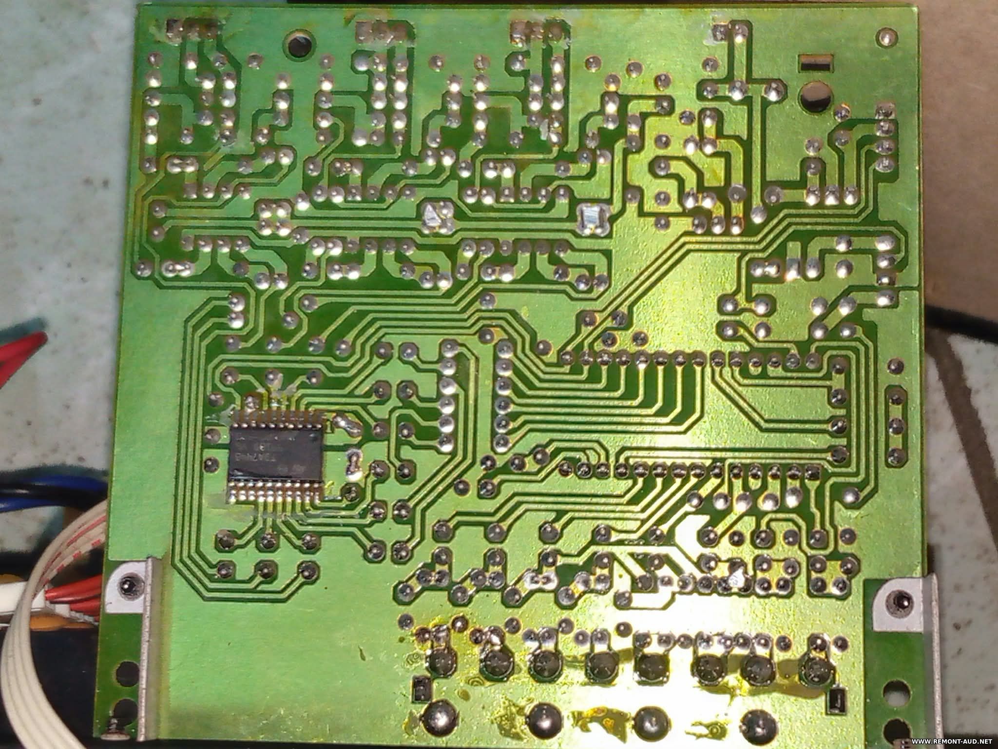

Наличие схемы: https://share.gemini.google/fMslCTu3J4LT
นี่คือบทความสรุปการ MOD วงจร M860 / FC730 ภาษาอังกฤษและภาษารัสเซียครับ
### **English Version**
**M860 / FC730 Subwoofer Bass Management Modification**
* **Problem:** The original circuit only routes the Front Left (FL) and Front Right (FR) channels to the active subwoofer LPF, leaving the Center ©, Surround Left (SL), and Surround Right (SR) channels without deep bass output. This causes thin-sounding dialogue and unbalanced tonal consistency during channel panning.
* **Solution:** Extract audio signals directly from the output pins of the volume controller (TDA7448 Pin 6 for Center, Pin 5 for SL, Pin 16 for SR). Sum these three signals via a resistor ($10\,\text{k}\Omega$) and a DC-blocking capacitor ($0.22\,\mu\text{F}$) connected in series per channel.
* **Injection Point:** Inject the combined signal directly into the Subwoofer channel input at Pin 15 (`OUT4/SUB`) of the TDA7448 (or the positive terminal of `C16`).
* **Result:** Full-range bass management across all 5.1 channels, preserving independent volume trim control while maintaining proper DC isolation and channel crosstalk separation.
