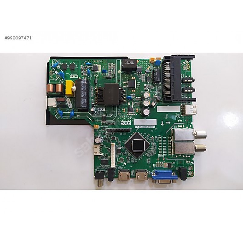

Parça Numarası: TP.MS3663S.PB805
Bilinen Marka/Model: Dijitsu DJTV431 43”
Tv Panel Modeli: KM043LDF00658
Main-EL.MS3663S-FE48V1
TK2303-027
306010JRX3663004
Panel-V320BJ8_Q01 rev-C1
